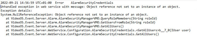

I am using two different XProtect Corporate Servers. One running 2022R1 and the other 2022R2.
Both my actual application and Test App are using the MIP SDK 2022R2.
The only exceptions/errors that I can see in the Event Server Logs are in the log from the 2022R1 Server, shown below
We tested following code sample with 2022 R2 server and 2022 R1 server. So far it has worked fine, and we could not reproduce the issue. I also checked logs and there are no errors/ exceptions there.
Can you please try the code on your servers that have the issue and see if you can see the issue?
