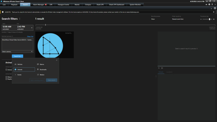

Hello Rie,
I successfully implemented the SearchAgent is a Smart Client plugin however i am facing a bug/issue. To simplify the issue i will explain it on the provided plugin sample SCAnimalsSearchAgent .
I am using the PluginSamples\SCAnimalsSearchAgent sample , when i provide an icon for the plugin using below
SearchFilterCategory = new OtherSearchFilterCategory(“Animals”, appIcon,
new SearchFilter\[\]
SCAnimalsSearchAgentSearchDefinition.ActivityFilter,
SCAnimalsSearchAgentSearchDefinition.FamilyFilter,
SCAnimalsSearchAgentSearchDefinition.SpeciesFilter,
SCAnimalsSearchAgentSearchDefinition.AreaFilter,
The icon for the plugin is showing but now the result images are also showing the plugin icon instead of the animal pictures.
if i set the icon to null when initializing the SearchFilterCategory the animal picture will start showing again.Can you please elaborate on this issue because i need to set a custom icon for the plugin and be able to specify an image for each search result.
best regards,
Gaby
Milestone Development will start an investigation.
As a workaround, please set a fixed size on the Image shown in the top-left corner of the search result (maybe smaller size).
Setting the icon size to 16x16 solved the issue.
Thanks a lot!
