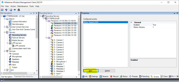

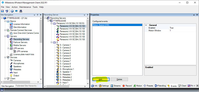

Camera events, the events you configure in the Management Client when you pick the camera and goto the Events tab, can only be triggered from the camera.
Other events, like user-defined events or analytics events, can be triggered from MIP SDK.Thanks Bo Ellegård Andersen for the response, appreciate the reply. Just a follow up query. Can we configure an event in the similar way as mentioned above and can that event be sent from the SDK, in that case will the camera start the live in the Milestone system.
Camera events cannot be triggered from the SDK (only from the camera itself), other events can be triggered from the SDK.
