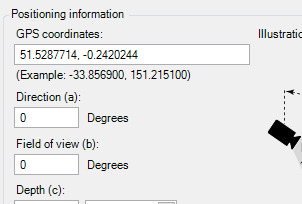

On the Management Client → Devices → Cameras you can find this:
What I want is to be able to set through the SDK, but I wasn’t able to, for now.

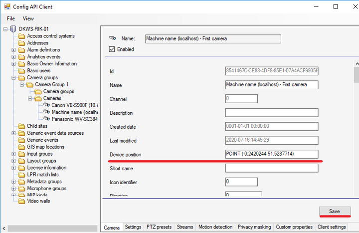

Can you please explore Config API Client sample?
https://doc.developer.milestonesys.com/html/index.html?base=samples/configapiclient.html&tree=tree_2.html
Please change Device Position and save it in the sample and see the change in the Management Client (please refresh it with F5).
When I update the GisPoint property in the same way as your example, it works fine on my end and I can see the updated coordinates after refreshing the Management Client.

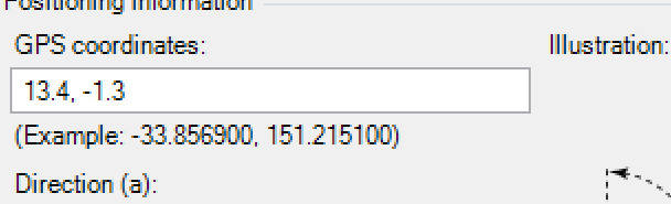

I noticed the changes don’t go through immediately , how do I refresh the Management Client so the changes are made in the same session? Right now I have to close and open the Client for the changes to update.
What’s the command to use so this refresh is made on the instant?
