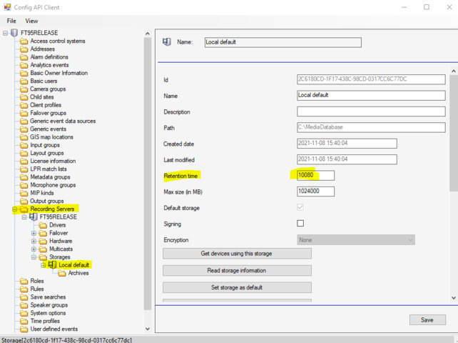

In order to get a storage configuration (retention time), please use ConfigAPI Client sample –
https://doc.developer.milestonesys.com/html/index.html?base=samples/componentsamples/configapiclient/readme.html&tree=tree_2.html

Thank you for this, but I have some concerns: In the ConfigAPI it seems like these values come back in a freeform “container”, but are not strongly typed. This seems great as metadata for the purpose of creating a “wrapper” type of UI, but less so for machine-to-machine consumption. This example above does not “know” fields are going to be on that page ahead of time… but rather gets a freeform container back that has an object with a description “Retention time”, of integer type, with current value 10080.
What I am trying to do is write a program that will be able to get this data from the server in all cases. What if the server is configured in French or Spanish? Will that field still be labeled “Retention time” or the localized equivalent?
