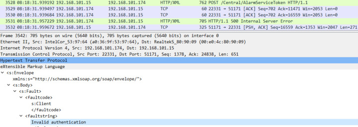

Following image shows the result of ‘POST /Central/AlamServiceToken’.

The screendump is a dump of the AlarmServiceToken (supporting AlacommandToken SOAP) that is used for basic users.
Please note that the AlarmService (supporting AlarmCommand SOAP) is used for AD users.

Our packet capture shows internal SOAP API return error code, but there’s no solution to detect this.
This is the problem.
