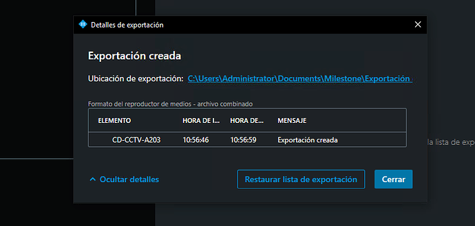

Hi @Bo Ellegård Andersen (Milestone Systems)​, we have done the following tests:
  • The export sample application is working for export.
  • Our standalone application has the following code. In the code, you can see that we tested 4 cameras with different start and end datetime. The result about these tests were unsatisfactory. You can see in the log the same message “No video in selected time period”
In other post I will send you the code snippet and logs.

note: The export sample application and the standalone application were executed on the same machine.
In addition, Our standalone application has the same code than the export sample application. In the following code:
if (this.fileName.Contains(“CD-CCTV-B501”))
the export sample application used the ToUniversalTime and for this condition our application used the same.

the old version is 20.2.2185.1 and the export sample application version is 25.2.17261.1.
My advise is that you should always build using the newest NuGets just like the sample does. Please try to take the sample as starting point and then lets it export 4 times after each other.
Finally we have arrived to the port. We have updted to the newest references and it is working right now. Thanks so much @Bo Ellegård Andersen (Milestone Systems)​
