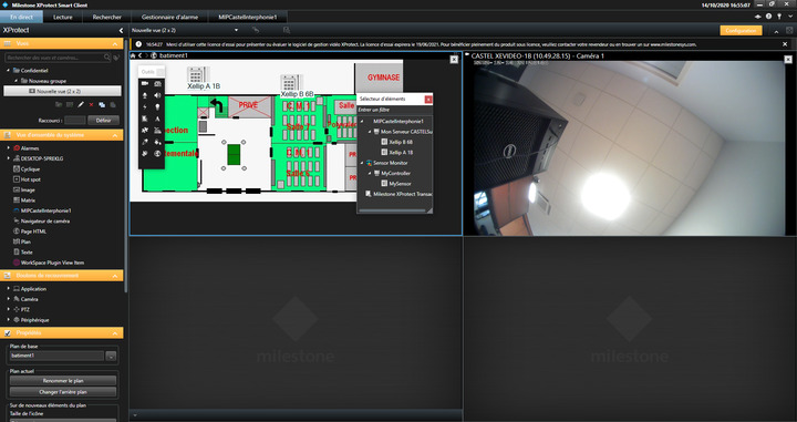

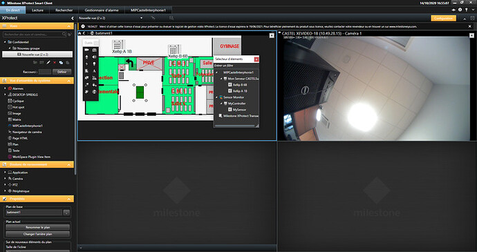

In the Smart Client when I drag a Map in a view i use the “puzzle” icon to add Plugin element on my Map. To do this, I have an Element selector to choose which items i want to drag on my map. This is very useful and it works very well.

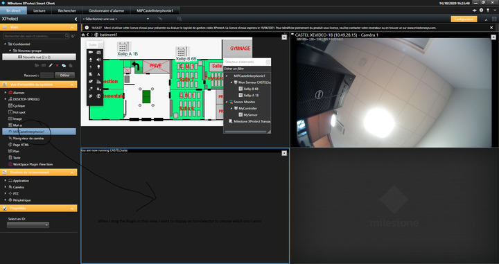

But I want to get the same Item selector when Idrag my plugin in a view. For example if I have 2 items, I want to drag item1 in a view and item2 in another view.
How can I display this item selector when I drag my plugin i a view ?

In the SensorMonitor sample, there is a Controller with Sensor item under the Controller.
In my plugin, controller is an external server and SensorItem are Intercom station. SO I have a server with Intercom station as child of the Server.
So when I drag the plugin in a view I want to display a selector in which I can select which intercom station item I want to put in the View.

In fact when I drag my plugin in a view, at the moment the view displays " You are now running …" But i don’t want this. I want to select one IpStation who is a child of my server to put it in the view. And I want to select it in an Item selector to drag it on the view.
At the end, I will have one ipStation per view .

Thank you for sharing the pictures, the idea sounds very nice, but we don’t have the functionality unfortunately. We will put it on the wish-list for future enhancement development work. A prioritization needs to be made by Milestone Product Management, so it is not possible to say when, or even if, this will be developed.
