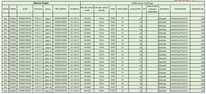

Hello! Sorry for the long delay. We got some feedback from one of our customers. Please find the file attached.
I am sorry, we didn’t get details about the version used but we are still waiting for feedback from another customer.

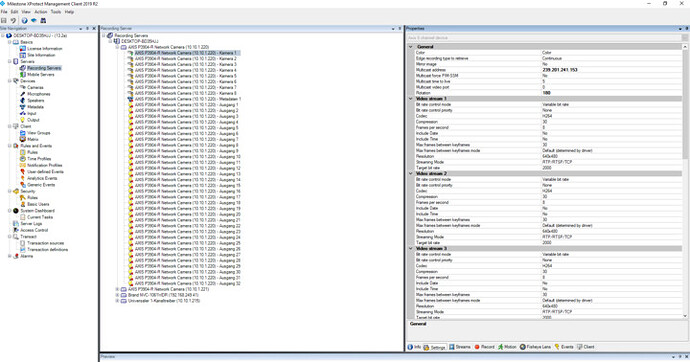

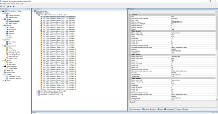

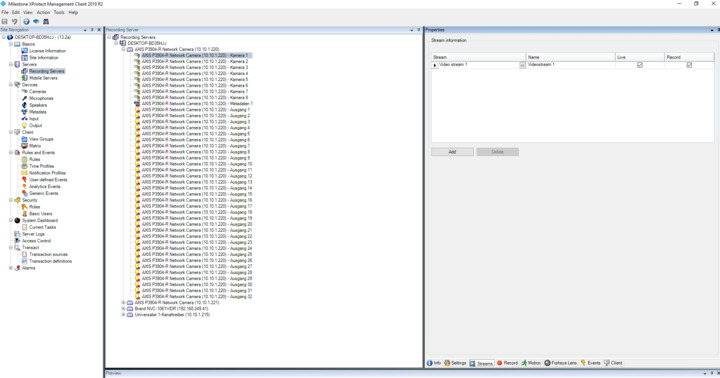

Can you please send following screen captures to us?
Screen capture 1 [Settings]
Management Client – Servers – Recording Servers – select a camera – select “Settings” tab.
Screen capture 2 [Streams]
Management Client – Servers – Recording Servers – select a camera – select “Streams” tab.

Hi,
please find the requested screenshots attached to this mail.
BR
Can you please upload the pictures here?
Settings screen shot
Streams screen shot
