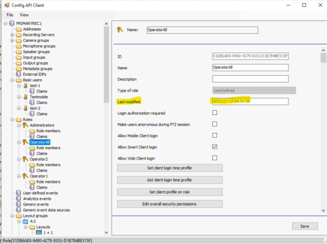

I would add, I don’t see a “Last modified” field at all.
This makes me think that I have misunderstood. Can you please show me what field should reflect the changes? Perhaps you can make a screen capture from the Management Client (or from the Config API Client) showing me the relevant field.
Another interpretation is that there is no “Last modified” field at all but you think there should be one, is this what you are saying?
PFA

The last modified on the role is changed when properties on the ‘info’ tab are changed.
There are discussions whether the implemented behaviour should be changed in future version, I cannot say when, or even if, a change will be developed.

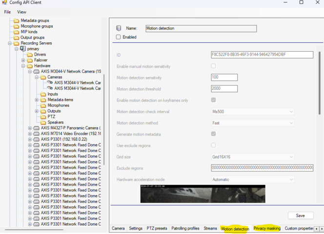

Hi @Bo Ellegård Andersen (Milestone Systems)​ ,
We also see the Last modified field gets updated when we change camera information, PTZ, streams, and settings but not updated when we change motion, privacy masking, and events in the same camera tab using the ConfigApi Sample tool

Your observation is correct. It has to do with how the underlying objects are stored in the SQL Database and are tied into the Configuration API, this means there is no easy fix. Milestone Development have made a note so they can consider how they might improve this in future versions, but there will be no fix for current or past versions.
