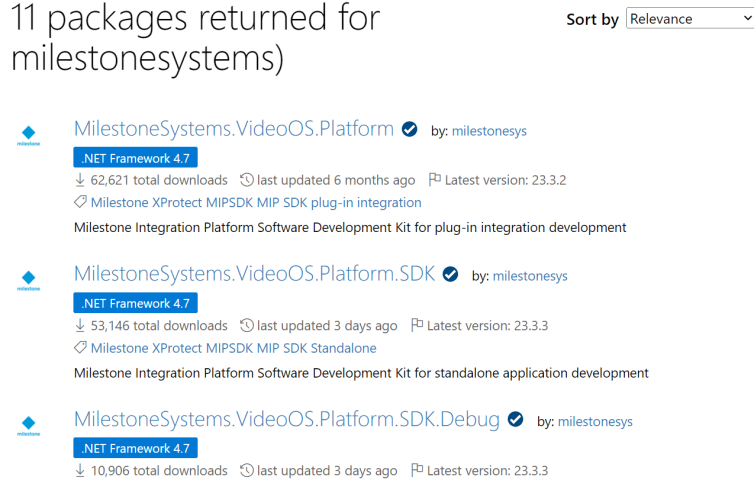

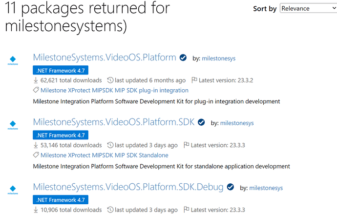

In NuGet.org we find these dll files : VideoOS.Platform.dll & VideoOS.Platform.SDK.dll. (as attached in Screenshot). The latest Autofac.dll file is not found here, can you share where we can find it.
You should not download dll files but use the NuGet to build the samples and your projects.
