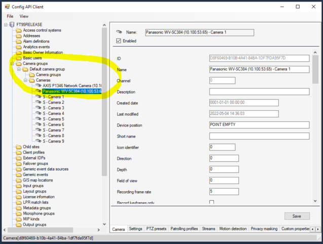

Config API Client sample might be helpful –
https://doc.developer.milestonesys.com/html/index.html?base=samples/componentsamples/configapiclient/readme.html&tree=tree_2.html
Thanks, Rie. I’ve played with this client quite a bit and have found it very helpful, but the only storage information I’ve found in it so far relates to entire live and archive databases. I haven’t seen anything in there that would give me the disk space used per each camera. Did I miss it?
