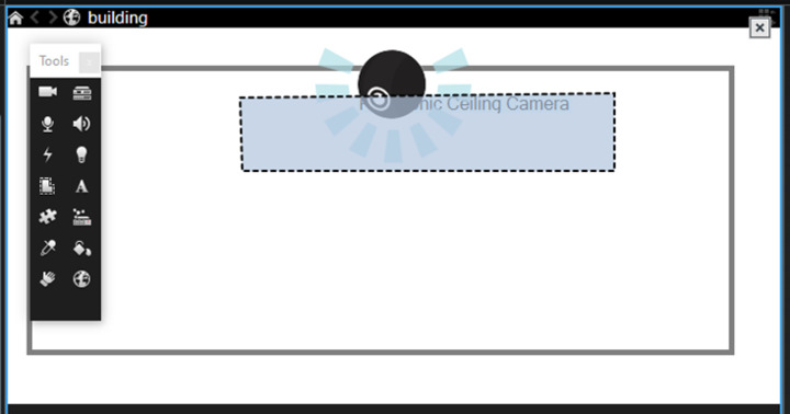

Start Smart Client and go to Setup mode.
Create a new view (fx 2x1 view) and setup Map view.
Put a camera on the map and select a camera and put it on the map.
map2Draw Hot zone.
map2(Something like this.)

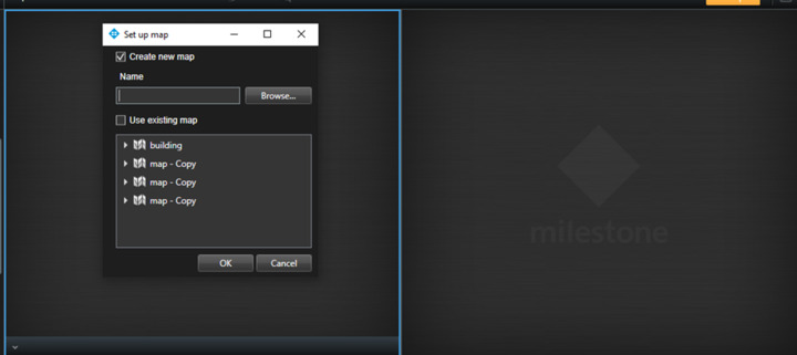

Double click in the Hot zone area and set up a new map for the Hot zone.

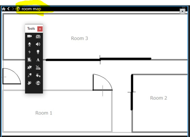

Escape from the Setup mode and again go to Setup mode.
In the blank view, create a map view for the hot zone.

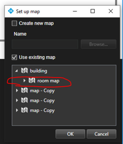

NOTE – please select Existing map when you setup the hot zone map.
Put a camera on the map (in the hot zone).

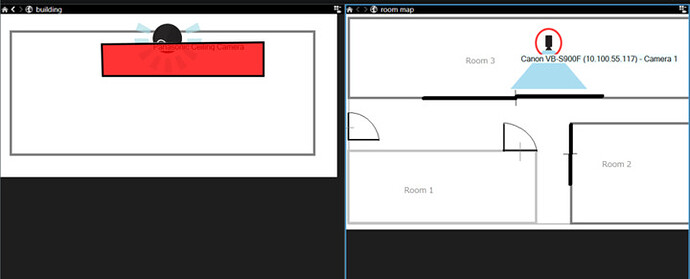

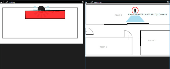

Escape from the Setup mode.
When you trigger events on the camera in the hot zone, then you will see blinking the camera in hot zone map and hot zone in the first map.
