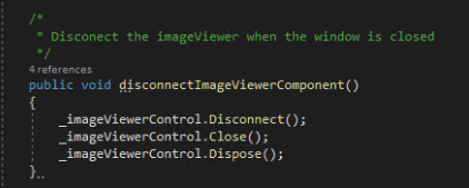

We are developing an application where multiple windows with camera videos can be opened. For this matter, we launch different threads with windows were the component ImageViewerWpfControl is being used. When we close these windows, we are disconnecting and closing the ImageViewers using this method, but we are still having the memory leaks:
Any idea of why is this happening?

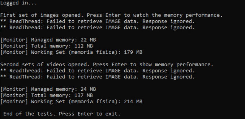

Hello, what we did with this demo are these steps:
  1. The first set of windows is opened.
  2. Close the opened windows.
  3. Press enter in the console and see the performance stats.
  4. Press enter again and the second set of windows is opened.
  5. Close these windows.
  6. Press enter and the new performance stats are shown.
We noticed that the second printed stats are higher than the first stats.

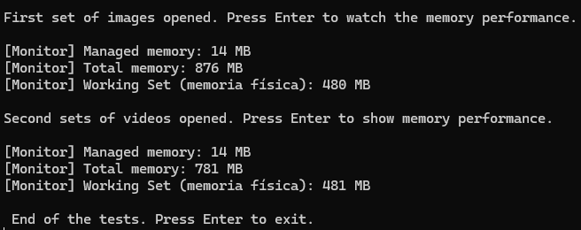

I am surprised to follow your steps and find
The numbers are not the same every time but not really indicating a leak.
On our end, we are observing a memory accumulation issue:
Furthermore, the more windows we open, the more memory continues to accumulate. We are conducting these tests within a virtual environment—could this be contributing to the issue?
Hi,
I have tried several times with your app and am unable to conclusively see any leaks. However, a few issues worth noting: The Closed event is triggered after the window is already closing, which is why there are occasional errors during shutdown of the windows (if the viewitem is trying to show an image in a window that no longer exists). Consider instead using the Closing event. Another issue worth noting is that you are creating leaks in the event handler on the Closed event. To avoid this you could use a private method, like this:
                void Disposer(object s, CancelEventArgs ea)
                    foreach (var child in totalGrid.Children)
                        if (child is ViewItem viewItem)
                            viewItem.disconnectImageViewerComponent();
                        else
                            //Do nothing
                    Dispatcher.CurrentDispatcher.InvokeShutdown();
                    window.Closing -= Disposer;
                window.Closing += Disposer;
                window.Show();
                Dispatcher.Run();
If you wanted to conclusively prove or disprove that there might be memory leaks in the ImageViewerWpfControl, you could try making a version of the application that continues to open and close windows, logging the memory use to somewhere more permanent than the console. Letting that run overnight should give a better indication.
