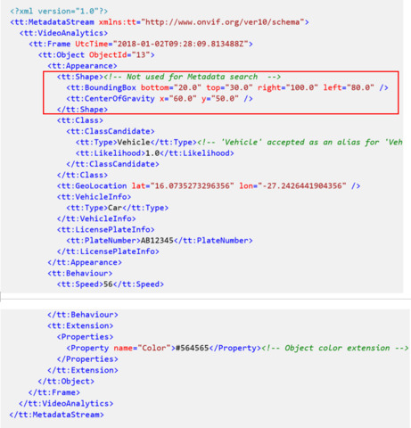

What are the coordinate rules of the metadata bounding box supported by Milestone, as shown in the red box in the figure.
Now my question is that the metadata bounding box of our camera is successfully displayed on the Live screen, but the location and size do not match. It may be that there is a problem with the conversion, so I want to ask.

If you look at this Bounding Box Metadata Provider sample, metadata bounding box coordination is like something like this - bottom=”-0.2499999” top=”0.25” right=”-0.25” left =”-0.75” and this is the way how to make proper size and location. We believe values in the range -1 to 1 will be interpreted as fractions of the image. Values outside the range will be interpreted as pixels, you will however never be able to know the size of display in the Smart Client. Please try out and find a suitable coordinates.
