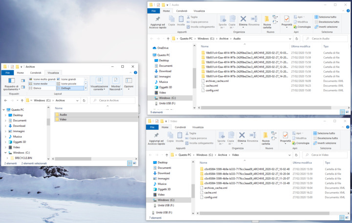

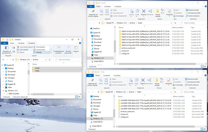

This is the folder structure that i use:
attached, you will find the zip of the xml files of the respective archives.
How you can see, i have some recording audio in one bank and some recording video in another bank. Each bank have only one file cache.xml to retrive the contents.
With this folders configuration i can hear only the first audio recording, but i can see the whole video.
If I move one “table” in the chache.xml file before the others, I will hear only that, as if the SDK only loaded the first “table” of the file and discarded the rest.
As example i send you the file cache_audio2.xml where i moved a “table” to the top. So with the cache_audio.xml i hear the audio from the begin to 10:03:42 if i use the cache_audio2.xml i hear the audio from the 10:03:43 to 10:20:05.
