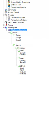

thanks again, but what i mean that when i add the MIP Plugin we want it to create the tree like you see in the pic below:
currently when we go over 2 child’s in the tree it wont add them.
we want to be able to add under each fence child another child and under it to able to right click and add fences with settings.
is that possible?
Thanks again
Tal
I just quickly added a 3rd level to SensorMonitor sample (child of sensors) and it worked fine. The intention is that only the types are shown in the leftmost tree in the MC, while the middle will show all items of the selected type, under their immediate parents. I agree that this is not always an ideal way of showing it (especially not when you have a large tree structure with many levels and branches), but that is how it is currently implemented.
