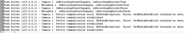

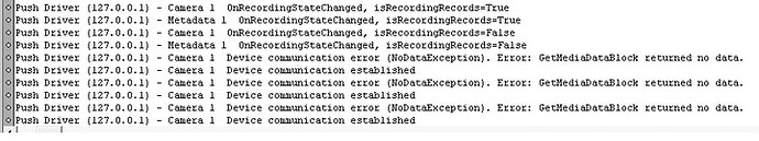

4. When I look in the Mobile Server log file DeviceHandling.log I see:
2017-03-11 03:59:28.947-05:00 [ 56] WARNING - a7537081-be53-4477-8631-d8cf3326a0e5 Video Push Driver (127.0.0.1) - Camera 1 Device communication error (NoDataException). Error: GetMediaDataBlock returned no data.
I assume this is because the JPEG frames that I am sending are not getting through? Does this mean I used the right parameters and url.. but the data was blank? If it means the data was blank could this be a CORS issue? Using Internet Explorer with cross domain security disabled I am able to make the request without any errors in the Developer Console of the browser. However when I use Google Chrome I see a SecurityError and some CORS messages which is what I’m working to resolve at the time of writing this.

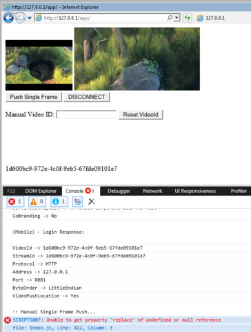

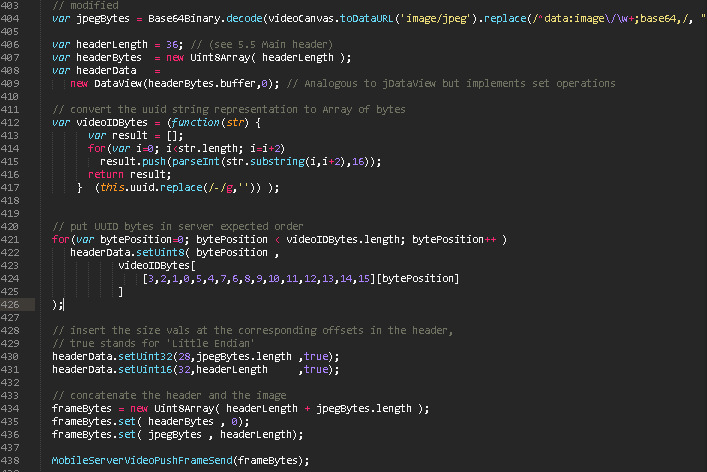

5. In the code snippet from the SDK below.. there seems to be an issue. This loop never gets called and ‘as is’ the page errors because of the uuid.replace is undefined. I apologize if I’m missing something, but does the uuid not exist in some cases or is this just deprecated? I know this was probably a dumb question, but I needed to ask it so thank you.

6. I would assume that this JPEG extraction snippet in the SDK would need to go in a event that does something like:
    videoContext.drawImage($this, 0, 0);
    setTimeout(loop, 1000 / 15);
    // perform JPEG operation and send via XMLHTTPRequest
    ... videoCanvas.toDataURL ... etc etc
The reason I mentioned this is it seems to me that the example in the SDK is only to show you how to send one frame which of course is not what we are looking for in the real world. So would I loop like shown above and send each frame in a XMLHTTPRequest?

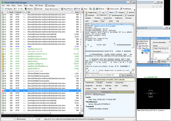

I’ve verified everything was as you said above and I’m still getting a Bad Request when I attempt to send a frame through to Milestone. Additionally in this first image I wanted to show that uuid.replace() error from the code snippet in the SDK that I said was failing above and you stated you would look into. As you can see below everything seems to be working as intended until I send a frame through. I see the JPEG binary coming through in Fiddler so I know data is going out, but I am missing something obviously. Do you have any suggestions? I was hoping to use the Milestone Mobile app to intercept and debug with.. to monitor its traffic and simulate what is being performed there, however it appears the Milestone Mobile app does not follow the same instruction and instead uses SOAP requests. My plan is to understand what is going on with the uuid code and recreate it in hopes to figuring out why it is failing, but even without that section of code I am still getting a Bad Request and correct me if I’m wrong, but I would expect to get a valid response if data went through, but the data was incorrectly delivered.
mobileserverlogfirewall
Additionally.. the successful log you see in DeviceHandling.log is when I utilized the Milestone Mobile App. My attempts are the GetMediaDataBlock returned no data errors.
It appears the Mobile Server protocol in the SDK is hit or miss as far as completeness. For example in the Mobile Server protocol - Decoding Frames section var uuid = dataView.getUUID(); is defined, however that is the only place uuid seems to appear.. so you create a var that is not used? This is for Decoding Frames and what I’m hoping to do is Encode them and Video Push so this is irrelevant to me, however the section in the SDK that does pertain to what I’m trying to accomplish also seems to be missing code.
In the Mobile Server protocol - Video Push section headerData is created, but never used? videoChannelURL is referenced, but never defined.. in Mobile Server protocol - Decoding Frames once again I see httpRequest.open(‘POST’,‘http://mobileserver.name:8081/Video/f3cad68b-8692-4068-a79b-fdfd58665699’); which seems to be deprecated and it appears Milestone now uses /XProtect/Video path instead of /Video. Back to Mobile Server protocol - Video Push I see videoIDBytes is a variable function and a for loop which states it: // put UUID bytes in server expected order … however it never shows what str you should pass to videoIDBytes and if the loop is immediately after the variable function is defined then of course it will be undefined seeming the loop does not appear to pass str.. instead it only accesses elements inside an array that does not yet exist (videoIDBytes)..

I was able to resolve my Bad Request problems and successfully push video into Milestone through the Milestone driver. As I mentioned before this line of code:
(this.uuid.replace(/-/g,‘’)) was failing due to uuid being undefined. I looked at it and realized that its replacing a hypen so the uuid it was looking for could possibly be a videoID or streamID or in reality any similar identifier that I specify just so the server gets the bytes in expected server order and has that uuid padding its looking for.. so I used streamID from the OutputParam and viola video push working as expected coming through the live preview in Milestone :slight_smile: ..
For anyone else trying to resolve this in the future.. In the RequestStream command response there is an OutputParam object that Milestone responds with that has a StreamID located in the object tree as shown below.. so I basically did this (you will have to replace response with your XMLHTTPRequest response object) ..
var streamID = response.Communication.Command.OutputParams.Param[1][“@attributes”].Value;
(streamID.replace(/-/g,‘’))
