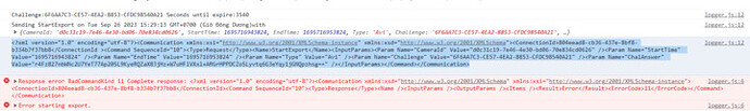

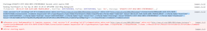

Hi, when we try to export video through mobile server web it fails (Error Code 11).
Sample code success with Milestone 2022 but fail with Milestone 2023 R2.
When we export video using Smart Client it exports correctly. What’s Error Code 11 means ?
Here I paste the request:
<?xml version="1.0" encoding="utf-8"?>
<Communication
xmlns:xsi=“http://www.w3.org/2001/XMLSchema-instance
xmlns:xsd=“http://www.w3.org/2001/XMLSchema”>
de865237-471b-47e9-89d5-f219062aa32e
Request
StartExport
And now, the response from server:
<Communication
xmlns:xsi=“http://www.w3.org/2001/XMLSchema-instance”>
1757eb0a-4c40-484b-b169-52a17e528448
Response
Error
11
Thank you!
Hi Son,
DeleteExport command had been deprecated for years, so we removed it altogether in 2023 R3.
The proper way to create an export is to create an investigation first and then use StartInvestigationExport command.
This is what Web Client does, so if you have troubles you can inspect the xmls which Web Client is sending.
