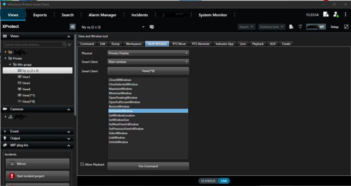

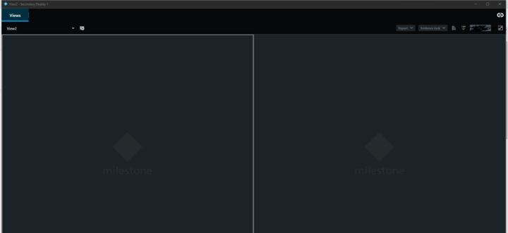

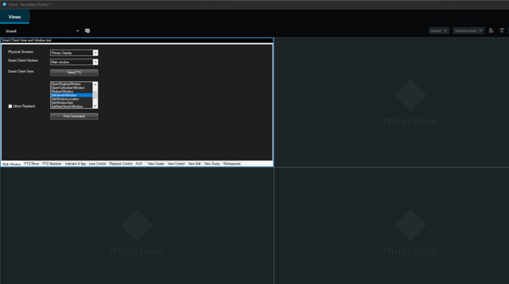

I am sending some view to Main window with Smartclient View And Window tool from Secondary Display 1 as shown in below image

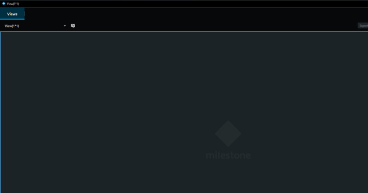

After click on Fire command button View(1*1) view is displaying on Secondary display 1 instead of Main window as shown in below image

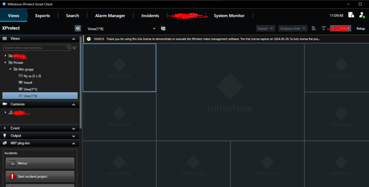

No change in Main window(Primary display)

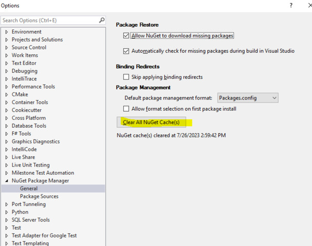

Can you please verify that you are using the newest sample and Nuget package? Also please make sure to clear Nuget cache in Visual Studio (Tools - Nuget Package Manager - Package Manager Settings)?

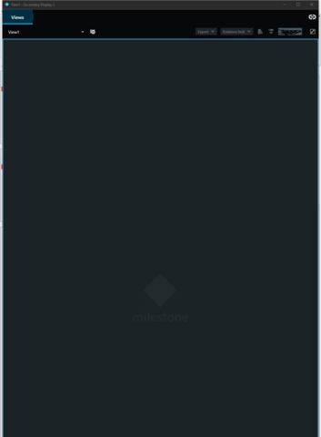

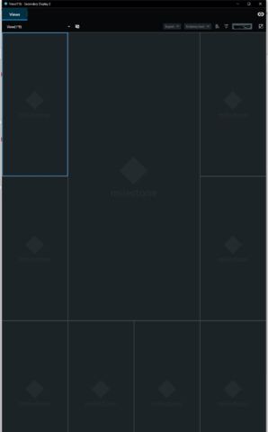

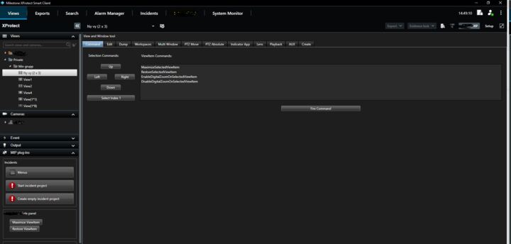

please have a look at below images
I have 3 windows main window (Ny vy(2*3)), Secondary diaply1 (View2) and Secondary Display2 (View1)
Now, I am sending SetViewInWindow command from ViewAndWindowTool sample plugin (which is existed on Main window) to change view on Main window.
But, Smartclient diplay2 view has changed instead of Main window.
Hope you get my point. please let me know if you have any solution.

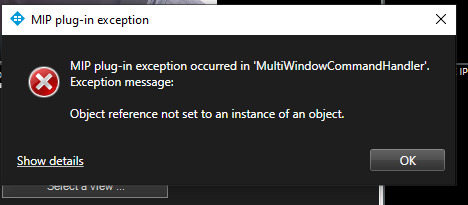

I have upgraded Smartclient 2023 R1 with Hotfix, SetViewInWindow is working fine but SelectWindow Command still raising Exception as shown in below image.

Milestone Development had investigated the issue and it turned out that SelectWindow command works only for floating windows, meaning that nothing happens if you pass on the Main window to the command, so it is by design. It has not been clearly stated in the documentation, but it is fixed in 2023 R3 in MIP Documentation.
In your implementation, we suggest that you could catch and ignore that error, as the command is not meant to work on Main window anyway.
