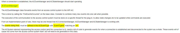

Taking a look into the current documentation:
Link Nº1: URL
Link Nº2: URL

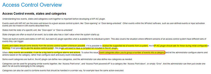

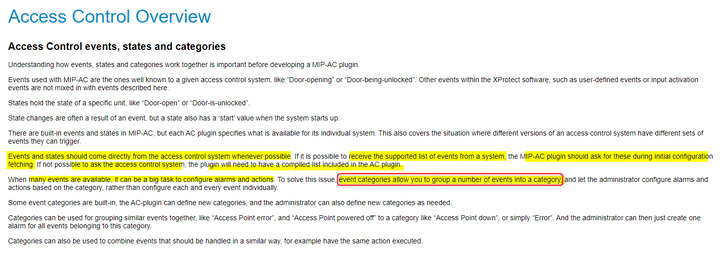

There’re important takeaways:
  1. AC is prepared to handle ‘AC systems’ eventTypes, and it’s advisable that those event types are retrieved at the AC configuration time (in MC)

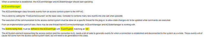

  2. Once the AC system is configured in order to process the events the method ‘FireEventsOccurred’ should be called:
    1. Dll: VideoOS.Platform.AccessControl
    2. Abstract class: ACEventManager

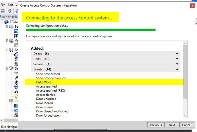

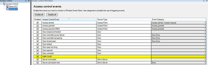

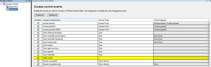

Thus, I did a small test, I’ve added a ‘Custom’ AC Event called 'Hello World’ and I’ve associated it to the Door Nº1: Thus, while configuring the AC System that event should be visible in MC:
then after fetching the data:

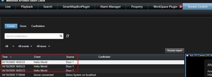

Once I’ve clicked on that button:
To sum up, if the AC system is setting up al the Event Types at the MC configuration AND the ‘FireEventsOccurred’ method is called) those events should be visible on the SC.
