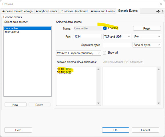

You need to enable and configure access for generic events before you can use them. In the Management Client → Tools → Options - Generic Events tab (the options dialog has many tabs and this is furthest to the right so use the arrow on the top).
You have to enable and configure which IP addresses are allowed to send the events..
Did you also see? - https://supportcommunity.milestonesys.com/s/article/how-to-troubleshoot-Generic-Events-guide?language=en_US
This we saw and was working from local milestone system, but from other virtual machine it was showing no access here as well, may be we need to configure allowed ip address which we need a menu navigation for, can you please give us a navigation for it..
Hi Bo Ellegard Andersen, Thanks for the reply, yes we did enable to Generic events, can you also please show navigation for “Enable and configure which IP address are allowed to send the events”, we need that guidenece please.
Yes super nice, makes sense.. yep we will try that out.. Thanks a lot this very hepful.. much appreciated
Got it working now thanks a lot much appreciated, a last question can we also give ip range instead of actual ipaddress in there.
You can input many IP addresses separated by semicolon but cannot input ranges of IP addresses..
