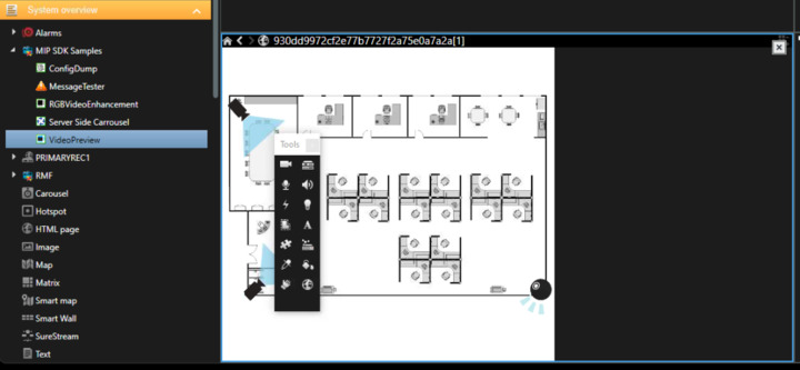

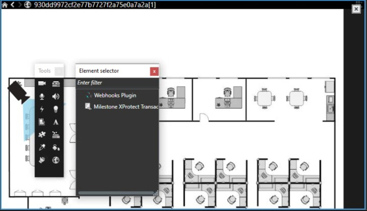

We have a customer with a request to place the plugin on maps, when click on the plugin icon on maps it provides live.
For example, can’t place videopreview or select on maps drawing tool plugin element

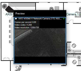

Like native camera preview on maps upon click, can we get same on sensor sample?
imageIn the context menu of the sensor sample, can we launch a dynamic plugin(video preview/server carrousal) .

While MIP Items is your chance to put something on Maps and Smart Maps you cannot achieve what you ask.
MIP Item actions are sent to the Event Server, here there is no understanding about what sent it, there is no mechanism that the server can send anything back and the client UI be part of the interaction. The Sensor Monitor sample and in general MIP item is loaded in the Event Server, and not in the Smart Client. When the Maps or Smart Maps are used it works because the server will give all information about what is in the maps. Actions are triggered on the server.
I am sorry if I have confused you and other readers by the previous answers that refer to functionality that will not help you achieve what you want. The functionality you are asking for, to put plugins with UI on Maps, is not possible, the functionality was never developed.
