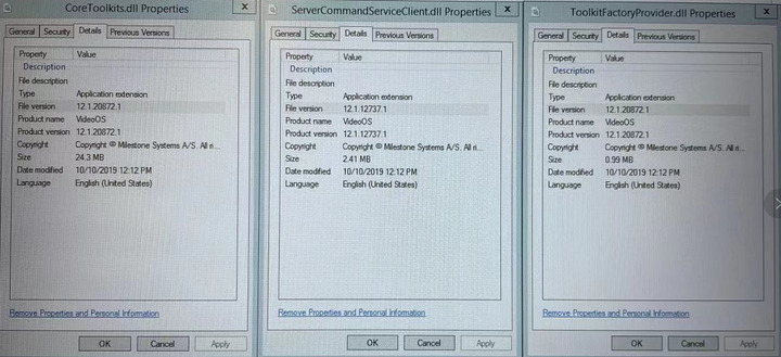

I have also attached mip sdk libraries used for existing application. Thanks!
