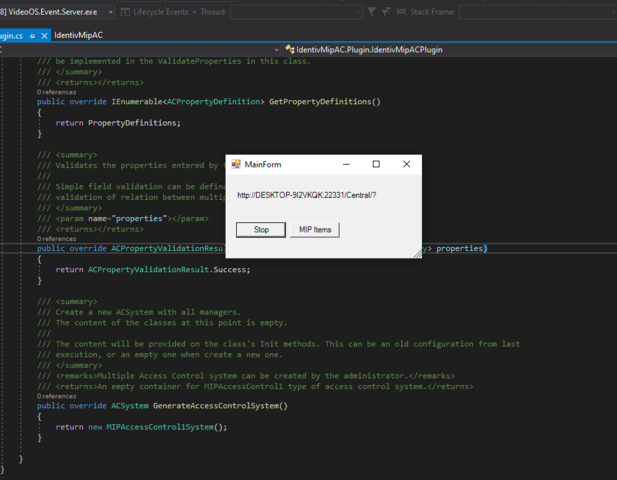

Getting closer…but the debug experience differs from the documentation.
This odd dialog pop ups up…clicking on MIP Items doesn’t seem to do anything…i’m not sure where this dialog is coming from.
I’m attaching a screenshot
When you debug the way suggested in the document you have stopped the Event Server service and instead start it as a WinForms application (by doing the “-x” parameter). So the odd dialog is in fact the Event Server “application”.
If you now have a breakpoint or similar you can get into your code running..
Thank you Bo.
I found that I have to run visual studio as administrator, or the event server isn’t actually running. (management client couldn’t find it) :slight_smile:
so that was the missing piece for me.
