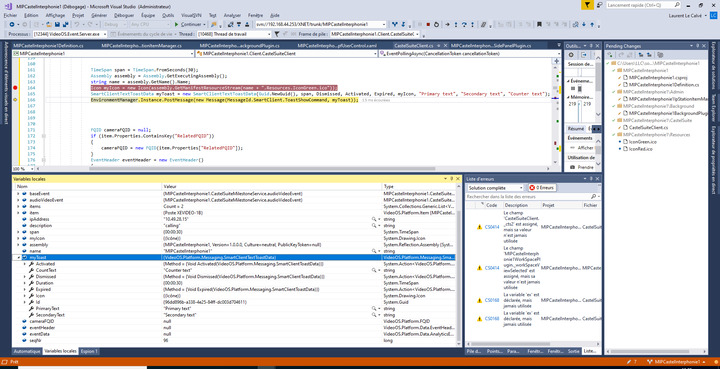

Here the toast object before Post
Thanks

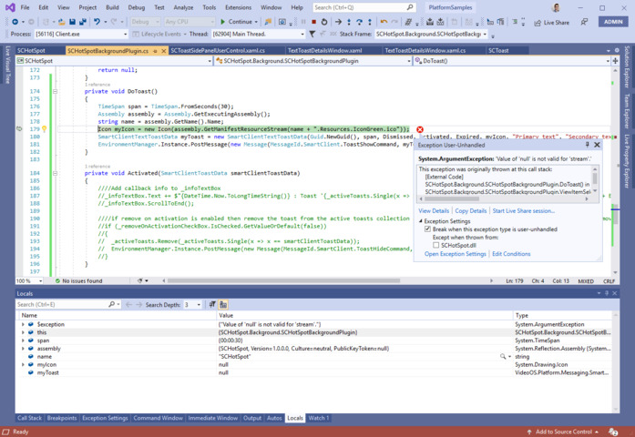

For simplest test I pasted your code into the Hotspot plugin sample. When I tried to put your code into a backgroundplugin in Smart Client I got:
Is this what you see?

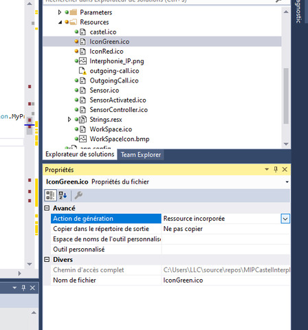

You have this exception because you need to incorporate your icon. See screenshot sent.
Of course, seems to me I should have realized immediately. I will find time and get back to my experiment and let you know what I observe.

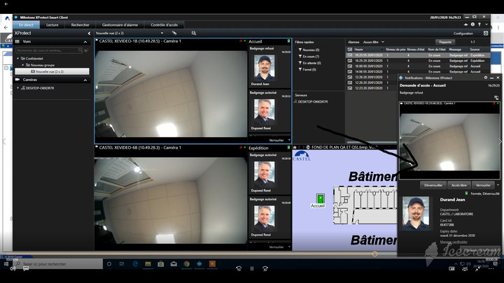

In fact I want to get in the Smart Client :
A MAp with all IpDoorStation displayed on the map.
When someone push the button of the IpDoorStation, I want that the icon of the IpDoorStation change ( this feature is working) and I want that a notification popup appears from the bottom of the screen (like Toast sample or like Access COntrol plugin see screenshot provided). In this popup, I will provide a button to answer to the call.

The code for the change of icon is executing in the Event Server, this is a problem, it does not execute in the Smart Client where it could simply launch a new window. Furthermore the Event Server background code does not know the identity of the Smart Client that pushed the button. It would be possible to implement code in the Event Server that would communicate with a Smart Client plugin when this happens but unfortunately it would then communicate to all Smart Clients as it does not know the origin of the push of the button.
