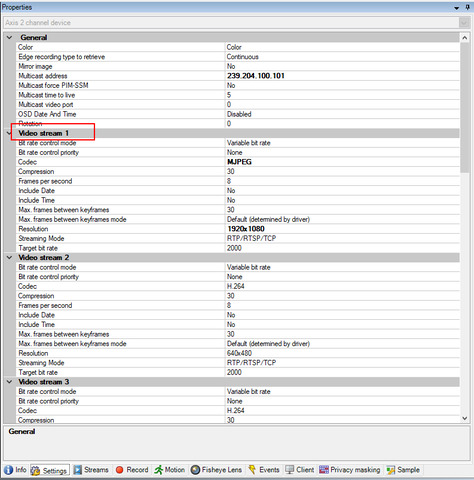

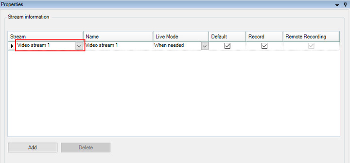

On this picture we see that the stream selected is “Video stream 1” (but that could be something else).
Then in settings we know the stream to configure is “Video stream 1”:
When doing this in code, Verint cameras return “Video stream 01” instead if “Video stream 1” for the settings sections (but the StreamUsage says “Video stream 1” so the name does not match).
