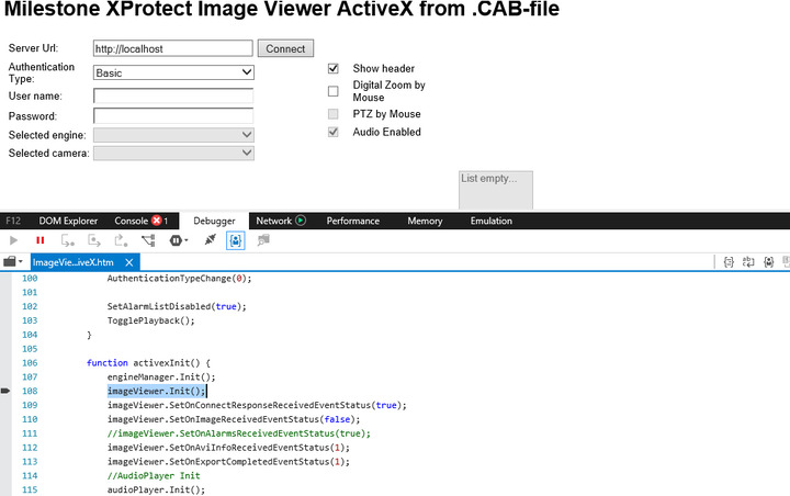

Hi, we’re in a situation where we have to connect to Milestone in our web application but the client doesn’t want to use/run the Mobile Server. In order to do this, we stumbled upon this discontinued ActiveX plugin of Milestone and wanted to use the same. However, when we try to use the same, it says, “Object doesn’t support property or method ‘Init’” for imageViewer.Init()

The above error was thrown when we tried to run the activeX sample unmodified in Internet Explorer (Chrome, Edge, Firefox, etc didn’t even load the plugins). We wanted to try it first before trying to integrate with out solution. Any prerequisite step that we’re missing?

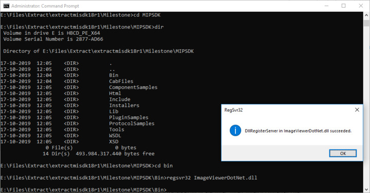

One thing that might be worth trying; try to register the activeX with regsvr32.
Tried to register the activeX with regsvr32. However, it doesn’t register them. Gives an error saying, “The module may not be compatible with the version of Windows that you’re running. Check if module is compatible with an x86 or x64 version of regsvr32.exe”
Tried it with both x86 as well as x64 version of regsvr32.exe and all other ways to register but couldn’t

I had the Bin folder lying in a unusual place but I saw..
ImageViewerDotNet.dll gets registered without any problem in mine. However, I was trying to register the activeX files (.cab files) and ran into the above mentioned problem. When I try to run the provided sample in IE11, I get the same error, “Object doesn’t support property or method ‘Init’” for this line: imageViewer.Init();

So registering did work but did not improve the issue.

Thanks, Bo. We tried the settings mentioned in that link too. But it didn’t help. Same error : “Object doesn’t support property or method ‘Init’” for this line: imageViewer.Init();

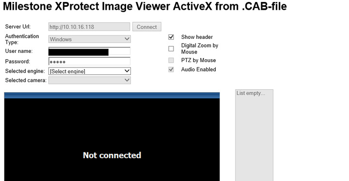

The sample goes from Not Initialized to Not Connected when using the Connect button. You must use Windows authentication users as the activeX does not support Basic users as implemented in XProtect c-code (XProtect Corporate, XProtect Expert and all Plus products).

So, the Initialize is happening only upon pressing the Connect button currently.
Also, we’re using Windows authentication itself currently.
