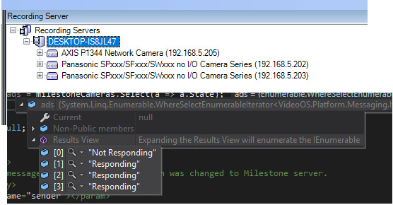

ProvideCurrentStateRequest returns collection on ItemState objects and I know status from these objects (responding, not responding, etc.). I can show cameras with statuses to user. This contains all I need but it is not reliable. I would need to restart event server before every ProvideCurrentStateRequest but it is not the best solution of others who listen on MessageCommunication.ConnectionStateChangedEvent
ConfigUpdated works via GetChildren and it returns collection of Item objects. These objects do not have statuses. If camera is not connected to the network I do not know it from this object. I can just diplay camera as working but it is not true.
I have 3 cameras: 2 connected to the network and 1 is not connected (cable is off). Provided status from SDK is: 3 cameras responding, 1 camera not responding. I am really not able to get current configuration with current status and keep it updated.
