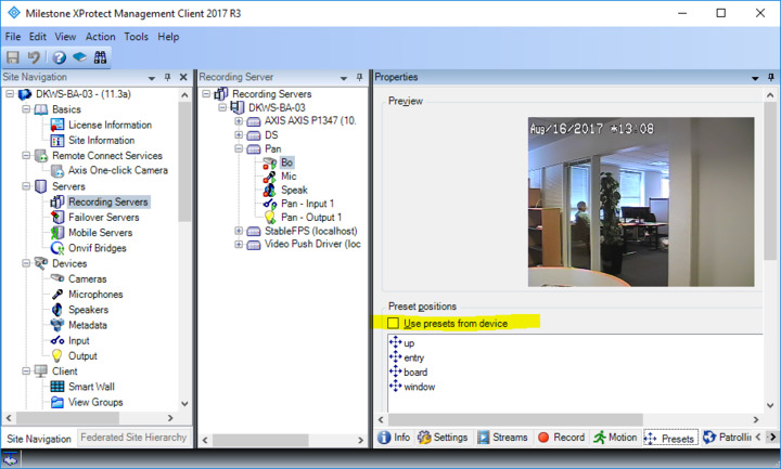

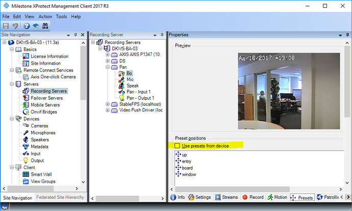

Yes, the PTZ Presets are stored either in the server or in the camera. You can see which scheme is used in this way. In the Management Client pick the camera, in the camera properties pick the Presets tab, on the presets tab find the option “Use presets from device”. If this is set the presets are stored in the camera, if this option is not set the presets are stored in the server.
Most cameras will have both possibilities but some will only support one of the two options.

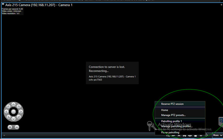

Is there a way to get the menu for PTZ control in own plugin, can you guide for some samples
please find the attachment
No. https://developer.milestonesys.com/s/question/0D50O00003ZQe49SAD/how-can-i-achieve-full-functionality-of-ptz-in-my-own-imageviewercontrol-in-my-plug-in
