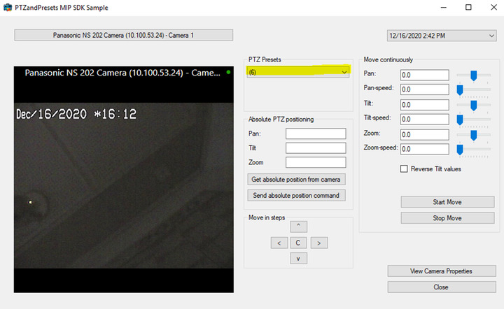

Let me explain how to do this -

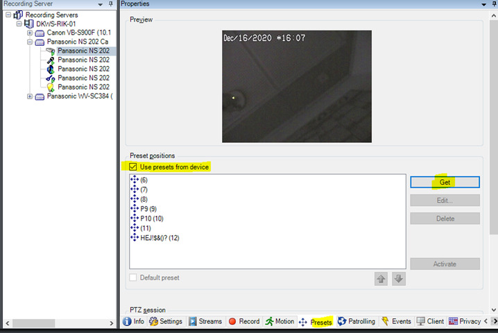

In Management Client, you will need to have presets settings on a camera in advance.
Start the sample and select the camera.
Set a break point on comboBoxPresets_SelectedIndexChanged.
Change the preset to new position and you will get the new position preset as an item.

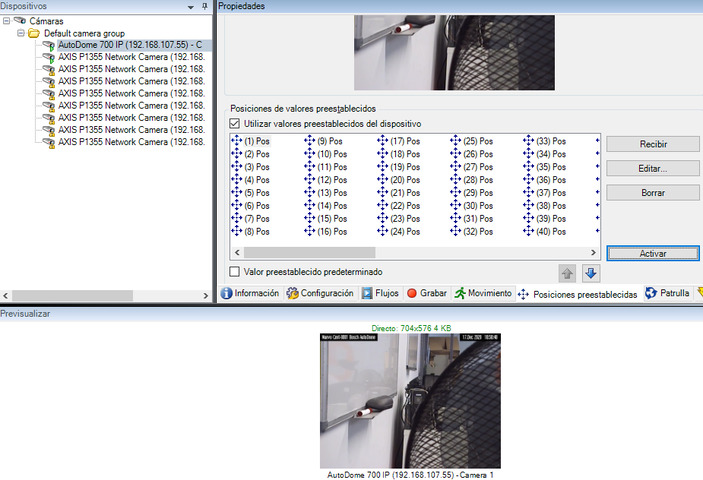

Perfect, I got camera presets in Management Client, but how can I get this list with MIP SDK 2020 R2?

Please see how the PTZandPresets sample does this. (Populate the combobox with presets in the ListPresets() method.)
With ListPresets () method I can see the list, but first I have to load them into Management Client. I want to do with the SDK the same thing that the “Get” button does, that is, I need to have presets settings on a camera in advance.

So this is configuration of the device which should be done using the Configuration API. Unfortunately there is no support for getting preset from the device implemented in the Configuration API. Currently I see no workaround besides instructing users how to do this using the Management Client.
The request for this functionality has been noted in the wish-list for future development work, but so far it has never been prioritized.
Ok, firstly I´ll have presets settings on a camera in advance and then I’ll use the SDK.
