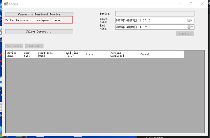

Hi,
We tried to run RemoteRetrievalTaskSample. However it failed to connect to management server when calling RetrievalTaskManager _manager = new RetrievalTaskManager(EnvironmentManager.Instance.MasterSite);_manager.Connect();. Any idea on what might be wrong?

The version is Xprotect Corporate 2018R3. The retrival task in the mart client works well. I didn’t see any error.
Testing this I made the observation that the sample works for me if I use a Windows user but fails if I use a basic authentication user.
Please test; is it the same for you, that Windows users work and basic users fail?
Yes, it’s the same for me. It works with windows user but fails with basic user.
