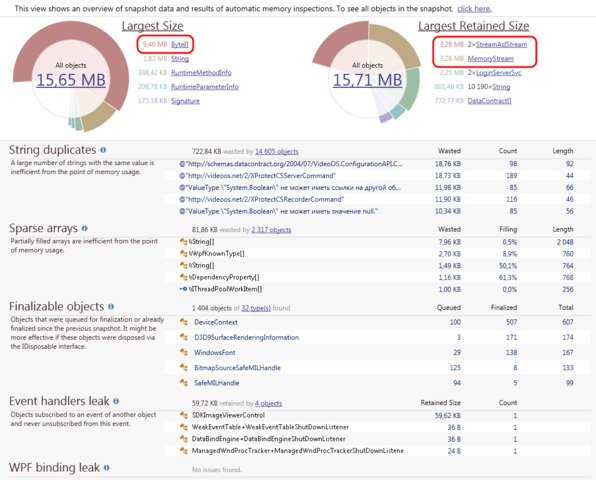

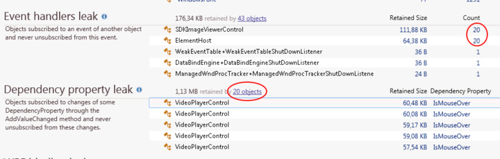

Hi, I discover resource release trouble in ImageViewerControl component. I analyzed your component samples VideoViewer and PlaybackUser with dotMemory and found that ImageViewerControl doesn’t release resources after dispose method. To recreate this you can just open few cameras in your samples. You can found some details from the dotMemory report below. Hope you can fix it asap, we have problems in our applications because of this.

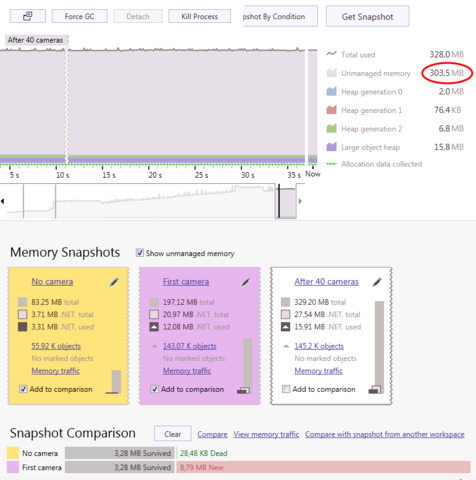

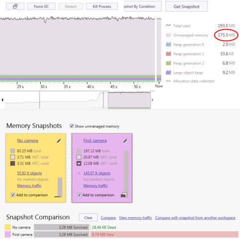

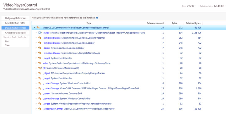

Thank you for this build! I checked it out with VideoViewer and our software and it works much better. But unfortunately, I found trouble with unmanaged memory. Same case as before just open cameras one by one in VideoViewer and unmanaged memory utilization increases with each camera as you can see on screenshots below. Probably there is some trouble in native code. This is a big problem for us as our users often switch between views of 16 cameras.
Screenshots description:
1. The first camera in view.
2. After 40 cameras.
3. No camera in view.
4. dotMemory report, possibly it can be useful for you.
