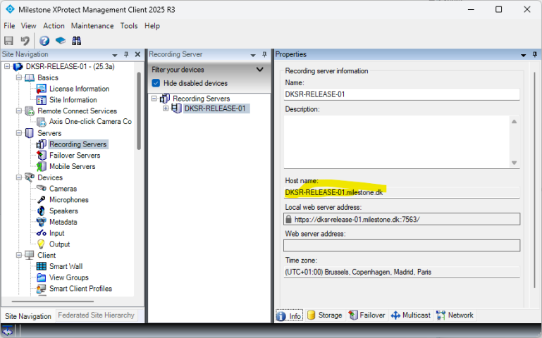

I do not get the same as you observe.
I do a
GET /api/rest/v1/recordingservers/[id]
which gives me
“hostName”: “dksr-release-01.milestone.dk”,
and this corresponds with what I see in the Management Client (MC):
In order for me to understand your observation please give me the details both from the API usage (request, response) and from what you see configured in the MC.
