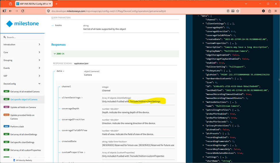

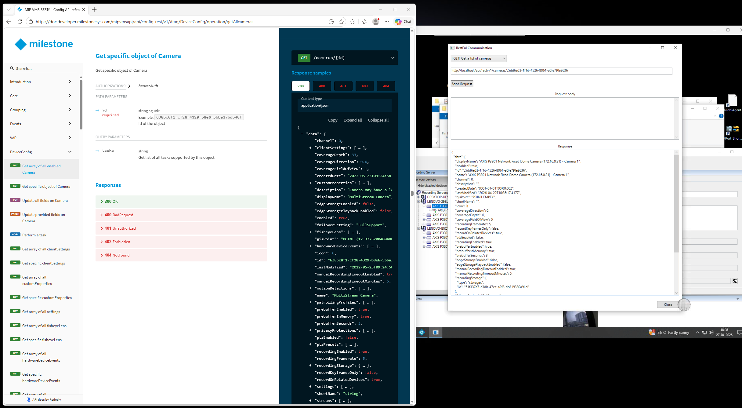

Using Corporate 2025 R3, trying to get camera using http://localhost/api/rest/v1/cameras/{id}
The document has a lot of information and details, but the output/response from the api is limited
PFA

In the Config REST API, several camera sub-objects are not returned by default. In the API reference, those parts are shown under the camera “response”, but they are conditional and only included when you explicitly request them via includeChildren. That’s why /cameras/{id} can look “incomplete” even though the docs show more fields.
Use the “resources” discovery on the specific camera:
GET /api/rest/v1/cameras/{id}?resources
This will list which child resources are available for that camera (and therefore what you can put into includeChildren).
A combined request is the correct approach:
GET /api/rest/v1/cameras/{id}?includeChildren=settings,ptzPresets,patrollingProfiles,streams,motionDetections,privacyProtections,customProperties,clientSettings,hardwareDeviceEvents
That forces the API to embed those child objects in the response instead of requiring separate calls like /cameras/{id}/streams, /cameras/{id}/settings, etc.
