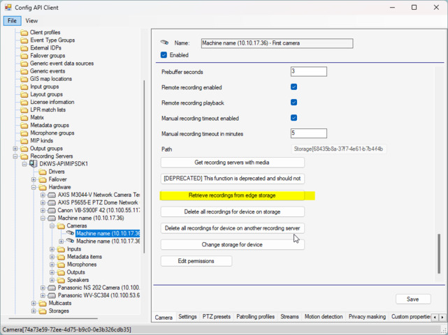

You can ask the recording server to retrieve edge recordings using Configuration API.
You can see it if you explore the Config API Client sample.
https://doc.developer.milestonesys.com/html/index.html?base=samples/componentsamples/configapiclient/readme.html&tree=tree_2.html
The sample is a bit of a mix between a protocol sample and a component sample, so I would like to point to..
https://doc.developer.milestonesys.com/html/index.html?base=gettingstarted/intro_configurationapi.html&tree=tree_4.html
https://doc.developer.milestonesys.com/html/index.html?base=gettingstarted/intro_soap_protocols.html&tree=tree_3.html

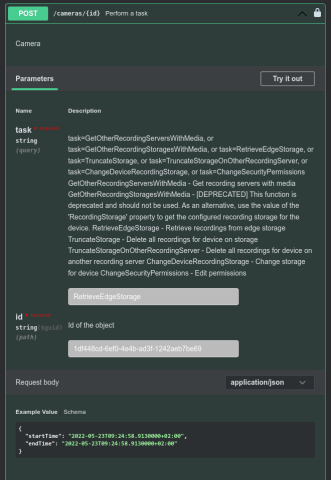

Using the REST API I believe this is the correct approach to do this:
@Bo Ellegård Andersen (Milestone Systems)​ Am I right?
Yes, I think you are right, I think it is the correct task.
