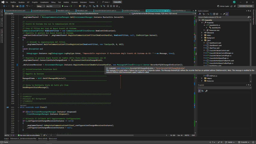

The recommendation is to subscribe using
EnvironmentManager.Instance.RegisterReceiver(GetFOChangeHandler, new MessageIdFilter(MessageId.Server.RecorderFQIDChangedIndication));
This will signal you in the event the uri changes, both going into and out of failover. (But actually you cannot tell if you are going into failover or out of failover.)
PS. Your question has triggered a discussion here at Milestone if we should enhance the API so that you could tell if you are in failover or not..
I can confirm that on my system the Receiver is never activated. The system is 2023R3 updated to the latest hot-fixes.
I invite you to note what the documentation says … I am not in those conditions.

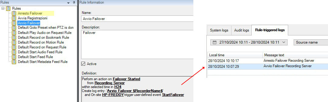

Bo,
Since it is possible to create Rules to Start and Stop Failover, isn’t there a way to intercept such Events without having to trigger a User Defined Event?
Thanks,
Frediano
