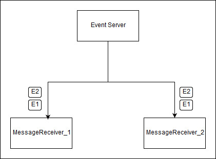

I want this:

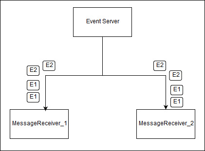

What happens:
Hi. Thank you for your detailed report! We have investigated this and found that it really happens if you do it within the same application. We will have a look into this issue. If you need several receivers in the same application to subscribe to the same event, then for now you can use a workaround by registering to the event once and then internally send your own notification to all your receivers.
