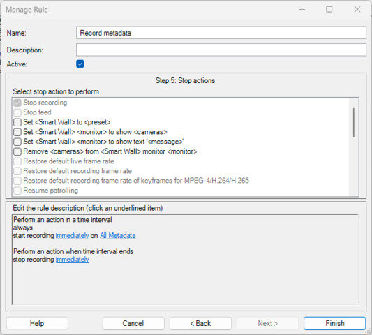

I am using MetaDataGPS example to save metadata and MetaDataPlayback example to read that metadata and I have noticed that metadata are saved only when video from that camera is saved, is this true?
I would like to be able to save only the metadata so they can be displayed on a heat map. For example, Axis Object Analytics is exporting rtsp metadata stream with detected person data inside that stream. I would like to extract that person location and save it, and eventually create a heat map of a certain area.
Best regards,
Hrvoje
This is an issue pertaining to configuration.
The default setup is that cameras record on motion, and when recording it will also record on related devices.
The way I read it you simply want the metadata device to record always. The easiest way to achieve that is to add a new recording rule looking a little like this..
