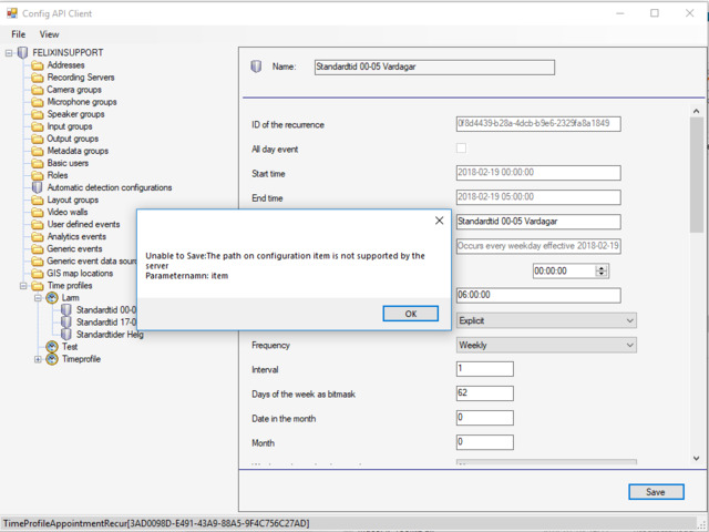

I’m running 2018 R1 Corporate. The ConfigApiClient returns error when I’m trying to modify time profiles.
What is the error you see?
Could you guys make a sample for TimeProfile modification? The documentation is really fuzzy.
The error is caused by the sample application attempting to save the child-item, it should save the item including child-items. Save should be performed on the time-profile not the individual appointment.
