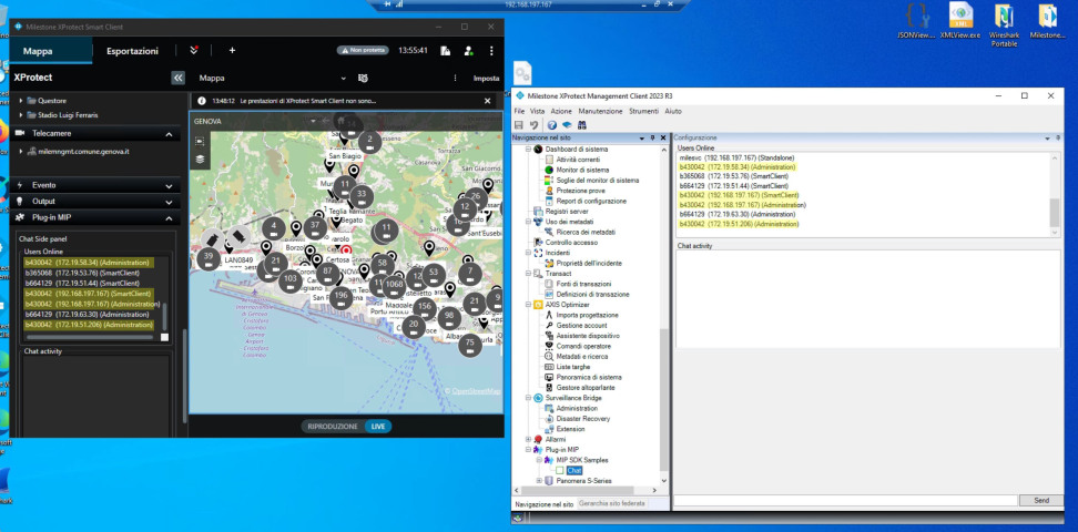

This is network pc with clients without any plugin. IP addr is 172.19.51.206 and User b430042
This is server pc with Chat plugin, ip addr is 192.168.197.167, same user
as you can see there are the 2 clients with Chat plugin and a MC with some User (ip 172.19.58.34) and ONLY MC from previous image … SC is not communicating login

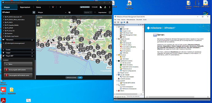

If you on the Smart Client (IP…206) do a Help ->About, can you verify that the Chat plugin is loaded?
If it is loaded please try to enable logging and see if you find anything in the SC logs (ClientLog or MIPLog).
How to enable Smart Client logging in 2020 R3 and newer
  • Go to Settings (gear icon in the upper right corner of the window).
  • Go to the Advanced tab.
  • Switch Logging (for technical support) to Enabled.

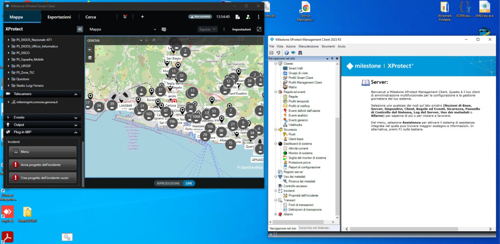

NO, on .206 the 2 client have no plugin
Frediano
