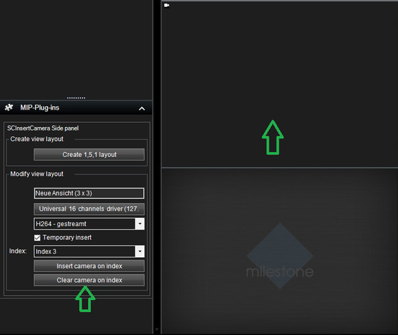

SCInsertCamera > Disconnect Camera
When using the “SCInsertCamera” Sample there is a button to diconnect a camera on the selected Index (Clear Camera on Index).
The camera gets disconnected when pressing it, but the window stays black instead of having the default backgound when nothing is connected.
How can i revert it to the default empty behavior? (With the Milestone Logo)
When you have the “Temporary insert” option on you can only set a camera where there is allready a camera (or blank Built-in Camera ViewItem) and you can only remove the camera of the Built-in Camera ViewItem and not remove the actual Built-in Camera ViewItem.
When you have the “Temporary insert” option off you can remove the Built-in Camera ViewItem and this is where you will get back to the default “blank” behavior.
Thank you for the fast answer. That means its also not possible to temporarly change a Builtin Camera ViewIten to something like a HTML ViewItem?
Correct
Ok Thank you
