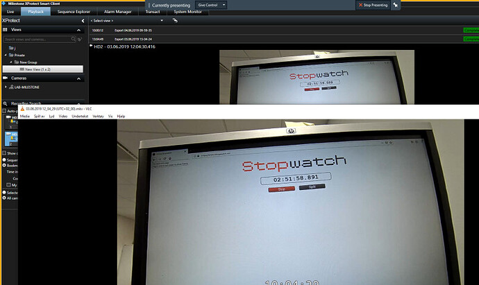

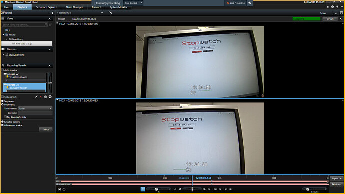

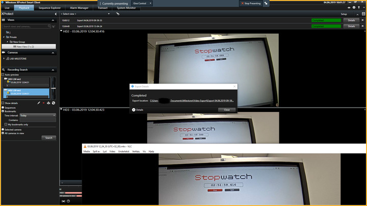

Thank you for your answer, I just tried 2018 R2 version, it is the same issue as in the 2017 R3.
Cameras are in sync.
2
Selecting the same time for two cameras to export.
It exported before the time is selected.
It exported before the time is selected for another camera as well, but the start time is even different for both cameras.
The same issue applies in the MIP SDK export.
