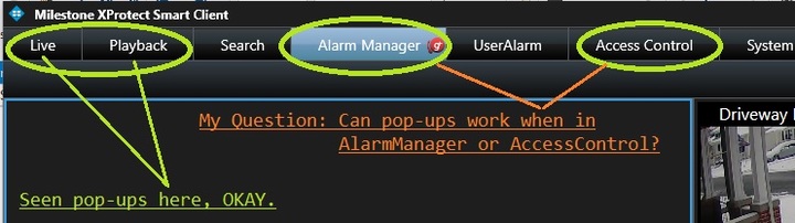

Should MultiWindowCommand work when in Alarm-Manager, or Access-Control?
SmartClient-Plug-in: I used MultiWindowCommand code from one of your samples. Sample was probably: “SCViewAndWindow”.
Works great when Mode.ClientLive.
My question is … Is it possible to pop-up a window when in Alarm-Manager, or Access-Control Tabs?
My code (base on your sample) seems to only allow floating windows when the TAB that is open is either Live-Tab or Playback-Tab.
More Info …

I believe the error is saying that you must be on the UI thread, but you are not.
Try to use
virtual void VideoOS.Platform.ClientControl.CallOnUiThread
    Action
    actionToBeInvoked
https://doc.developer.milestonesys.com/html/index.html?base=miphelp/class_video_o_s_1_1_platform_1_1_client_control.html&tree=tree_search.html?search=callonuithread
