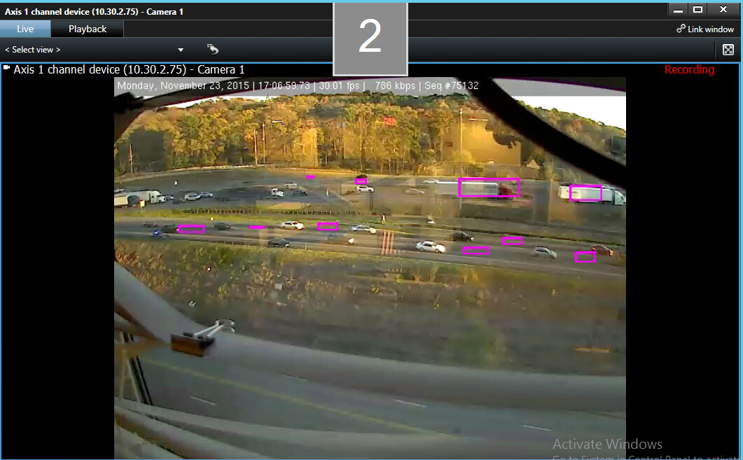

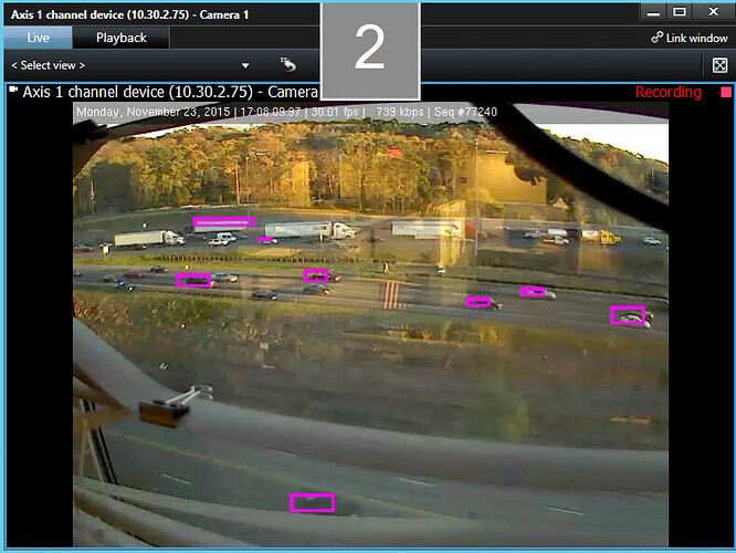

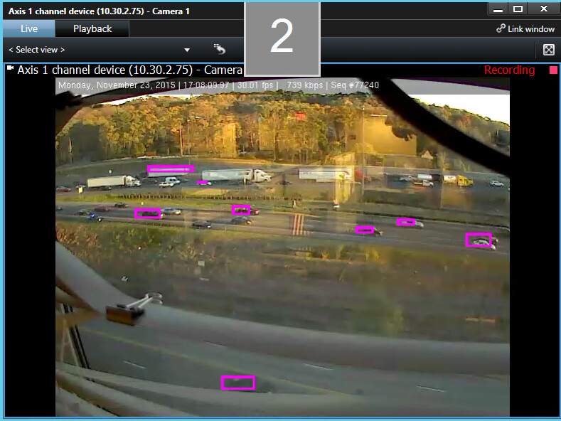

Found a way easy to reproduce this problem:
1. Open smart client and run a video in Live view for a while, the pink bounding box is perfect drawing on moving object, no delay. see picture below.
2. Click Playback viewer and move the bar and run playback video for a while.
3. Click Live viewer again, you will see delay, the default pink bounding boxes are not sync with moving object anymore.
