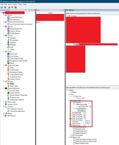

Have you checked this out-of-the-box functionality? If yes, what is the thing that doesn’t fit your needs? (see the attached image)

Outstanding! That is a perfect solution for our situation. Thank you. Your screen shot provided the answer.
