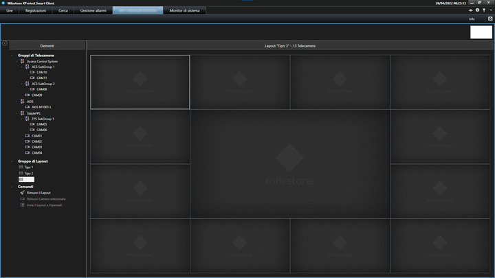

These are specific View (layout) for the videowall …
and this is the workspace dedicated to videowall
I used ClientControl.Instance.GenerateViewControl(…) to insert the view in a WPF control (actually it is a Grid).

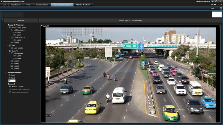

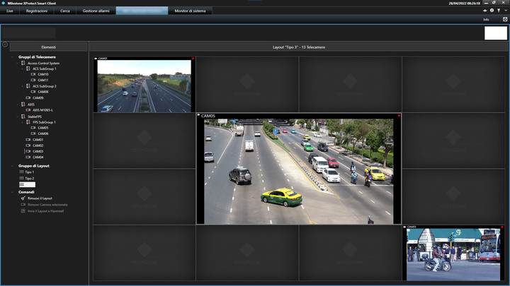

This is after dragging&dropping camera from left …
and after double-click on a specific viewItem
The problem is that the View is not linked with Client because the selected ViewItem has not “Azure” border and plugin are non receiving any indication after registering for SelectedViewChangedIndication, SelectedViewItemChangedIndication, SelectedCameraChangedIndication, so even if we can ‘see’ camera plugin can’t know which camera are in which ViewItem
