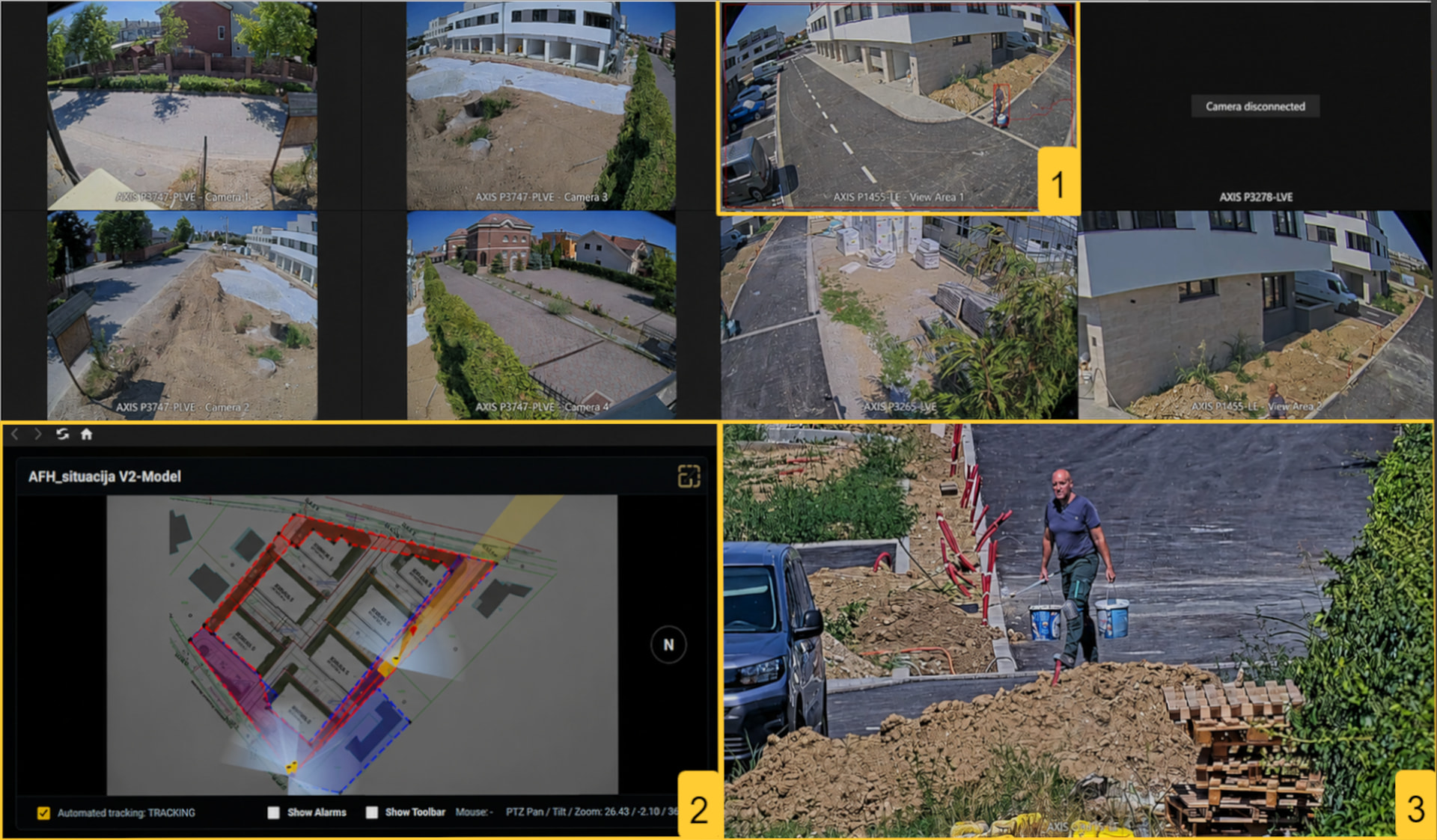

I would appreciate your advice regarding web application integration in XProtect Smart Client 2026 R1. It seems that I may be missing the intended integration approach.
The attached image shows what I would like to achieve in Smart Client. It is a screenshot from Axis Camera Station Pro showing video streams together with a web application. The web application is our ACAP running directly on an Axis PTZ camera.
The scenario is:
  1. Axis Object Analytics detects a person and sends the detection over the LAN to the Axis PTZ camera.
  2. ACAP on the PTZ camera places the detection on the map and checks it against user-defined areas. If the relevant conditions are met, acap raises an alarm and directs the PTZ camera to track the object.
  3. AOA on the PTZ camera then performs a second, independent detection to confirm the object and to reduce the number of false alarms. Further actions depend on the user-defined configuration.
I tested the built-in Web Page functionality in Smart Client, but it does not display the application as a current standard browser such as Chrome, Edge or Opera does.
What is the recommended and supported way to integrate a web application like this into Smart Client 2026 R1? Is the new microfrontend platform intended for this purpose, and is there an example project that demonstrates the recommended approach?
