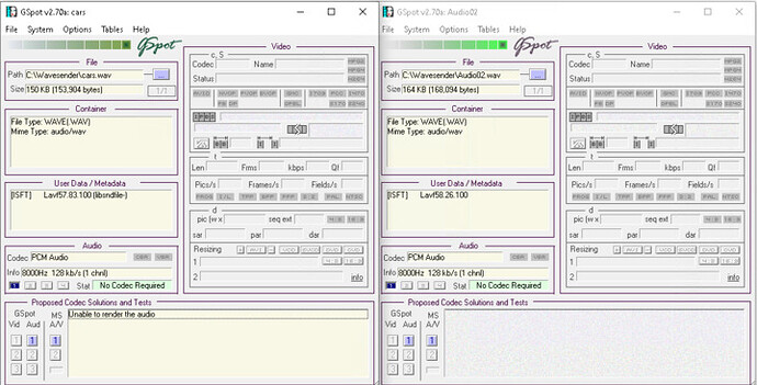

I have around 20 wav files that I would like to be able to play out to speakers. Only some of the audio files I have will play they are all PCM, 8KHZ and mono. The only difference is that the ones that work were encoded with LibAVFormat version 57 where all the ones that dont work are versions 58 and 59.
The left side of the screenshot is the working one where the right side is the one that wont play

A developer analyzed and found:
The second file doesn’t work, because its header is not entirely correct or at least I can’t find the information on whether it is valid to be structured like that.
Hey Danny, this will be resolved in 2023 R3 :slight_smile:
