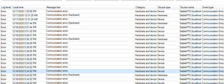

Stable FPS communication error
I installed Stable FPS with bat file from MIP SDK.
I wasn’t able to run neither test video, not my own video prepared with tutorial of Milestone.
I found those errors in the log, can it be connected to license limits ? Or how can I debug my stable fps devices ?
Turns out when you configure Stable FPS connection localhost didn’t work for my installation.
I changed localhost for 127.0.0.1 and Stable FPS started showing test videos.
